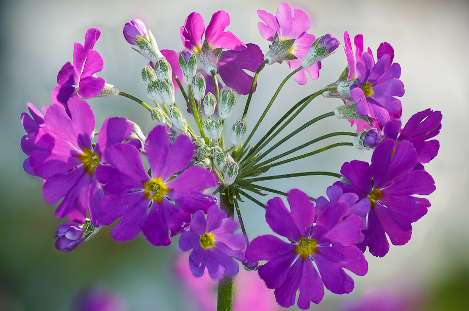

Firstly here is the shot you'd normally take. The subject is not particularly small so I could shoot with a little distance - I'm stopped down to f/11 for increased depth of field which even with the LED ring light required I shoot at ISO 1600 at 1/100th. I've focused sort of in the middle of the depth of the front face of the subject and as you can see it's sort of sharp in limited places - it's not horrendous but it's not great
Here is the result of stacking 12 images shot again at 1/100th but at f/4.5 meaning I only needed to be at ISO 320 - IMHO whilst not fantastic is still a much better result
