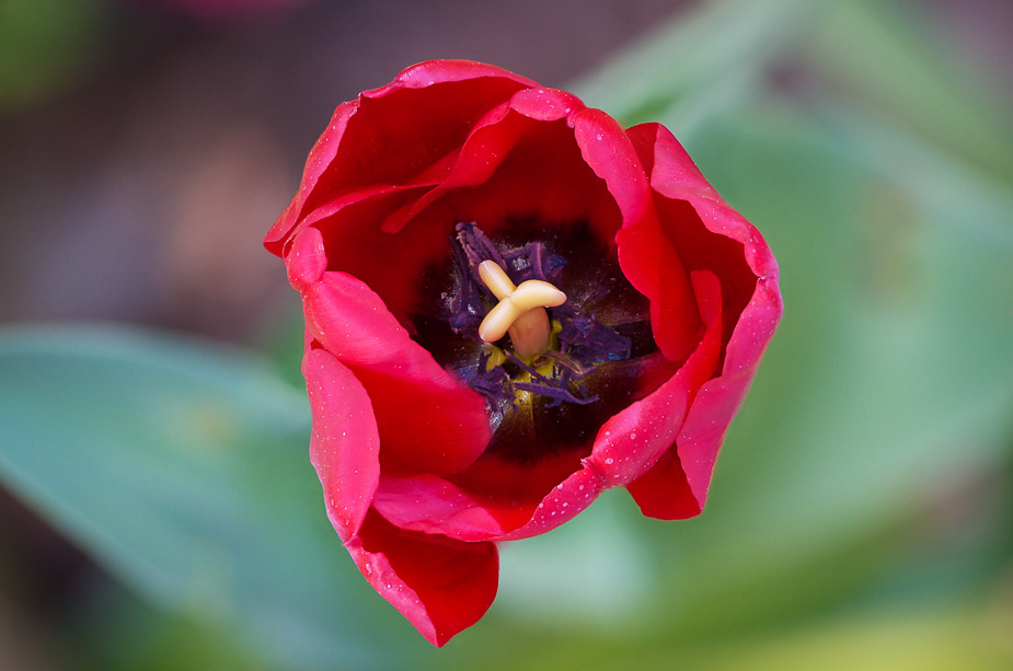

The stacked image of this tulip using 12 of the 19 frames I took [1/160 sec at f/3.2, ISO 640] (again wind was a factor here with the stem swaying in the light breeze - still the software has done a remarkable job of auto aligning the subject for me)

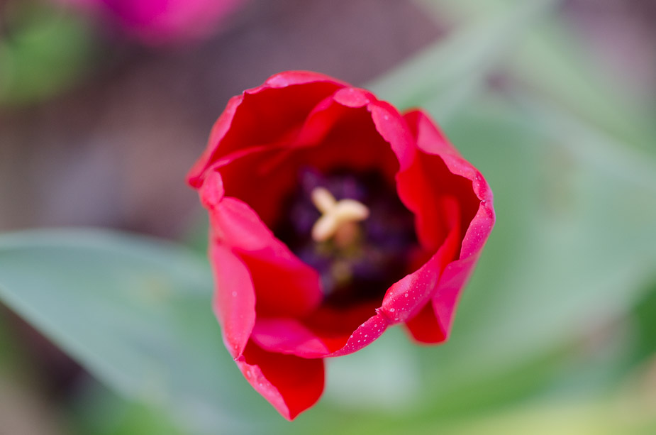

and here is one of the individual frames for comparison

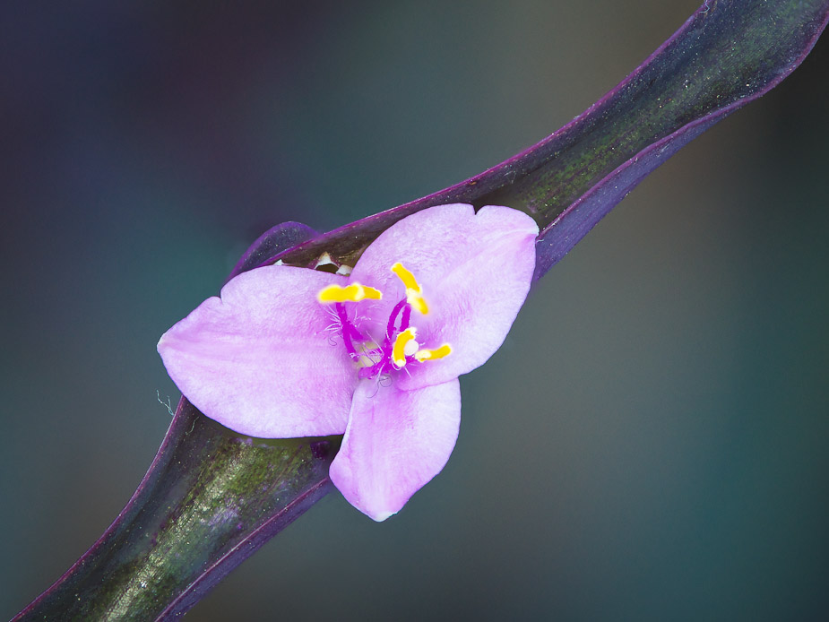

I'm really surprised this next one turned out at all - this stem was swaying around quite considerably and I had little hope of it stacking at all - however both sets of images I stacked worked - here this is the stack of 19 images [1/160 sec at f/4, ISO 1000]

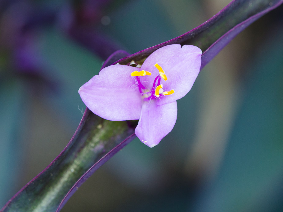

and for comparison a single frame at 1/15 sec at f/11, ISO 800
One further tip I have with focus stacking is this - I stack the images to produce the result with a much sharper main subject with vastly increased depth of field but I then generally blend back in the softer and smoother background bokeh from one or more of the source images (often the nearest focused frame). Sometimes the stacking process produces a slightly ugly background which is mostly a reasonably soft blur but some edges can get enhanced/sort of sharpened by the process. Basically the buttery soft bokeh background from the source frames are generally much nicer.
