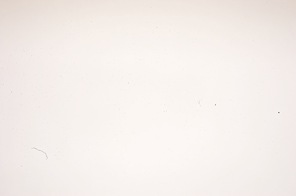

Postby katweazl on Sat Jan 28, 2006 10:58 am
Anyone want to do mine?
I have a dust bunny plague of biblical proportions!!!!!!!!
This is a white sheet of printer paper....and it is clean.
I must clean it!!!

Postby gstark on Sat Jan 28, 2006 11:18 am
katweazl wrote:Yeah I got one off him.....these are welded on!!!!
What technique are you using for the camera's blow job?
Please be detailed and explicit.
Seriously, please describe fully the steps you're undertaking; most of these seem to me to be blow-awayable.
Postby leek on Sat Jan 28, 2006 11:21 am
katweazl, Are you sure that the fibre is on your sensor? It looks too sharp to me.
Does it show up if you swap lenses? It could be on one of your lens elements.

Postby katweazl on Sat Jan 28, 2006 11:25 am
Well Gary,
I put the camera on bulb setting and fire the release and then put the rocket as close as I can to the sensor then blow!! And I don't know if it makes any difference but I try to hold the camera as upside down as possible so the dust falls down and out.

Postby katweazl on Sat Jan 28, 2006 11:29 am
leek wrote:katweazl, Are you sure that the fibre is on your sensor? It looks too sharp to me.
Yeah Leek.....it is always there. I took the reference shot above with the kit lens and the one of the sea urchin at the bottom of this thread with the 50mm 1.4

Postby gstark on Sat Jan 28, 2006 11:35 am
Joel,
Ok, your technique sounds fine.
From the statin' the bleedin' obvious pile of questions, are you blowing in the correct area? Remember that the location of the dust, as shown in the image (BRH corner for one of those pieces) is not going to be where you see it in the image, because of the way that lenses flip and reverse the the image onto the sensor.
So ... this piece of dust will actually be at the top of the sensor, and in fact, I'd be somewhat surprised if you could not even see it, were you to open the shutter and, under a reasonable sort of desk light, actually the sucker.
Looking at your test image, there's a couple of other major bunnies, but otherwise nothing too severe, btw.
I'm seeing lots of speckles, but I'm not too sure that I'd be overly concerned because they're so small.

All I know is if my sensor looked like that I would be using alcohol (preferrably red - Shiraz or Cabernet work well), a spatula, a pec pad, and eclipse fluid.
I have not used a blower since I borrowed one from a camera developing store and it infected my sensor with about 10 times as much dust as it had before I went in. First and last time for me, dunno what the hell they do with their blower.
Wet sensor cleaning works well for me, but would more accurately be called "damp" - too much alcohol leaves streaks... but all that's been said before.
